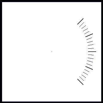

I need this kind of lined tick mark, and I known how to make it now, (by Excel language).
Now I want to make this surrounded the circle (360 degrees) and how to make 3 needles, not only one.
